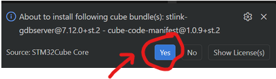

I only get this type of question:

@piotrk
So you're able to access to proper servers.
And you're getting expected notification asking you to agree about some extra material install.
If you accept it should solve your debug experience issue.

The first screen i posted here is the result i get when i click this Yes and i get errors such as the first photo I posted or this:
If this would be so easy to just click yes i wouldn't post here, unfortunately it isn't ;(.
