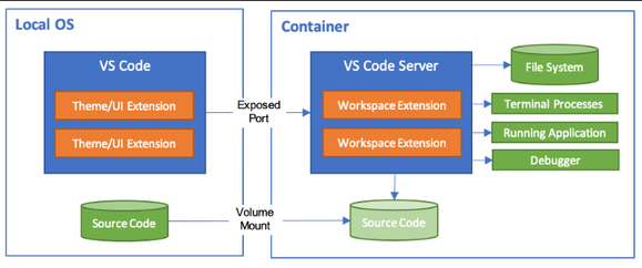

2024-07-11 4:37 PM - edited 2024-07-11 4:45 PM
I only have the "Default' profile. And since it works very well on the host machine, I think it is not the issue you have suggested.
Image from Visual Studio Code. Developing inside a Container.
And due to the way VSCode extension works, the host machine must have the extension installed to use it inside the container. Therefore, I think that the secons issue is also not the case I am experiencing now.
