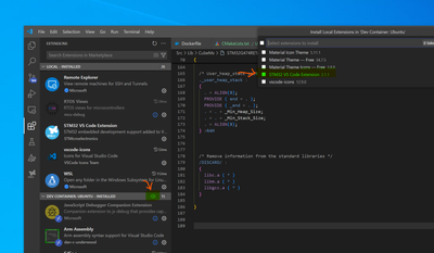

with the help of https://community.st.com/t5/stm32-vscode-extension-mcus/stm32-vs-code-extension-and-devcontainer/td-p/659247/page/2 I found a solution which works for me.
My setup I'm running a devcontainer inside WSL, so the remote connection is windows -> wsl -> devcontainer. For me it seems that the STM32 VSCode must run in the devcontainer and must be disabled in the local installation (like some other extensions). There are two problems, first the extension itself doesn't give the opportunity to install it anywhere else than in the local installation (windows). To get around the issue you have install it locally and then press the cloud symbol on the dev container section in the Extension Tab. Then you can select the STM32 extension to installed in the devcontainer.
The second issue is that, the that instance which is locally installed is not disabled, instead it is still the main instance searching for c++ extension, which locally disabled and enabled in the devcontainer. A solution is now do uninstall the STM32 extension locally. After that reload the vscode and the extension should work in the devcontainer.
I hope this helps finding a solution to get the extension working out of the box.
