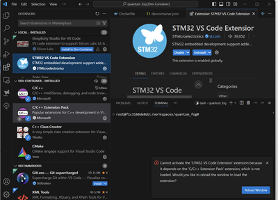

I am a happy VSCode developer using docker devcontainers to create an easily reproducible environment for development. I am struggling with a strange bug with the "STM32 VS Code Extension" (v2.0.1).
If I try to access it, after opening the container, I get the following error:
"Cannot activate the 'STM32 VS Code Extension' extension because it depends on the 'C/C++ Extension Pack' extension, which is not loaded. Would you like to reload the window to load the extension?"
This is strange because the C/C++ Extension Pack is loaded and part of my dev container.
I have the option to "Reload Window", but hitting it only results in a reload and the same message popping back up.
Has anyone been able to use this vscode extension inside a devcontainer?

Thank you for looking into this, @Nawres GHARBI
"Debug Console" and "Terminal" are both empty, no text there.
See attached photo.

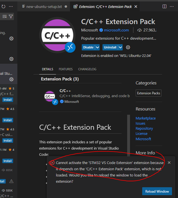

Same problem here:
reinstalled, rebooted etc etc.

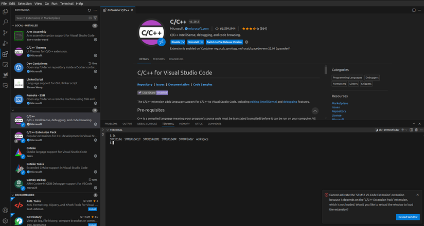

I'm having the same issue. It looks like the STM32 VS Code extension is installing locally instead of in the container. Since C/C++ extension is installed in the container, STM32 VS Code extension doesn't see it.
Ideally, STM32 VS Code Extension and STM32CubeMX should be in the container so we can generate code to the source directory in the container. That way we don't have to make the source directory available to the host (major performance hit while compiling), or sync it through a remote GIT repo (creates unnecessary commits, and add an unnecessary step to the process).
