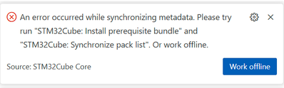

Just upgraded to the latest version of STM32Cube for VS Code extension (3.6.4) and now the extension stopped to work. I've tried reinstalling the extension pack several times. Every time after the bundle was installed an error show up saying "An error occurred while synchronizing metadata. Please try run "STM32Cube: Install prerequisite bundle" and "STM32Cube: Synchronize pack list". Or work offline."
Running "STM32Cube: Install prerequisite bundle" from the VS Code command palette will result in a message saying "No STM32Cube bundle to install", subsequently running "STM32Cube: Synchronize pack list" will return the original metadata synchronization error.
I checked my HOME/Library/"Application Support"/stmcube/ directory, the bundle/ folder seems to contain what I expected, things like cmake, gnu-gdb-for-stm32 or the stink-gdbserver, etc. However, the packs/ folder is empty, not sure if that's the problem.
