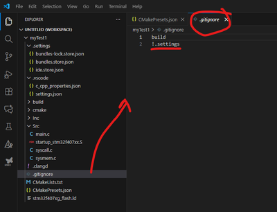

@jwichmann why not adding these .settings & .vscode stuff to your source control resources ?
Myself I'm not hurted to consider any tool has the need for internal metadata ... they are part of the project kind of.
Looking at STM32Cube native proposal creating a so called empty project an .gitignore file is promoted ... it's crystal clear .settings has to be preserved

@jwichmann you are kind of confirming all my points :-).
@jwichmann wrote:I found out that if I keep the .settings/ide.store.json file, I can achieve the project setup with the desired default settings. Even if CMake configure is executed automatically three times, twice with compiler errors and the third time correctly.
Demonstrates these metadata are must have. Why are they must have ? Because they are supporting your local system install management promoting to VSCode extensions paths to must have binaries which are compilers, debuggers acting under the hood of VSCode. VSCode is only a GUI ... all the rest is out of VSCode.
Stuff is failing at first ages because .settings metadata not taken into account at first. At first regular CMake Tools extension is acting and this extension is not aware of STM32Cube additions. Post CMake Tools contributions STM32Cube is acting and by magic stuff starts to work.
@jwichmann wrote:Because user-specific configurations are also stored in the .settings and .vscode directories. In my opinion, these have no place in a GIT repository.
Yes and I bet assumed by ST Thanks some other comments. Rational is to ensure reproducibility if you're sharing your project to a friend. Keeping these *bundle* stuff will kind of force your friend to execute your project back enjoying the very same setup. Thanks these metadata your projet is really self contain ... not only application sources but tools moving with.
WDYT ?
