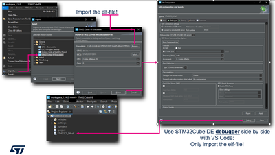

One way of squeezing out maximum "developer efficiency" given the current state of the free ST IDEs is to combine VS Code and STM32CubeIDE:
This dual-usage is fully possible by:
Step#3 is accomplished by this wizard in STM32CubeIDE:
Full source code look-up, c-line / assembly instruction stepping and hyper-linking to symbols/code will work despite that the actual c-code is not imported in the CubeIDE project.

2024-05-25 2:44 PM - edited 2024-05-25 2:51 PM
Of course you can (and should) keep the .ioc files.
> it mentions that you can still use this extension with CUEBIDE projects but with some extra manual configuration but I am unable to find how to set that up.
As @mattias norlander wrote here and in earlier threads: CubeIDE can create a lightweight project from existing .elf file for debugging it in the CubeIDE debugger. Actually this project is an "unmanaged" Eclipse CDT project. You can enhance it, add various settings to assist editing, add the build command and so on.
