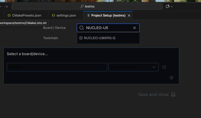

When I setup my STM32CubeProject the NUCLEO-U5A5ZJ-Q does not show up as option. No U5 devices show up. Is there a pack or something else I need to install?
Thanks

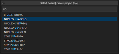

Thanks @vincent_grenet . The sync failed due to certificate issues. Zscaler is being used so I set NODE_EXTRA_CA_CERTS appropriately and now everything seems to be working. Thanks

I confirm that this board is supported.
Could you please try using the VSCode integrated terminal to execute the following command? Then, please try creating a new project again. (Assuming you are using STM32CubeIDE for the Visual Studio Code pre-release extension pack setup.)
cube pack sync
