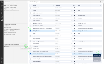

@Kraal JLink and Clang bundles are not installed by default when installing our extensions, they are installed later on purpose, at project setup when Clang is selected as toolchain, and at debug if you select the JLink probe.
However you can force a manual installation of these bundles before moving into offline mode via the Bundle Manager :
2025-09-30 1:33 AM
@Julien D Thank you for the explanation, it makes sense now.
