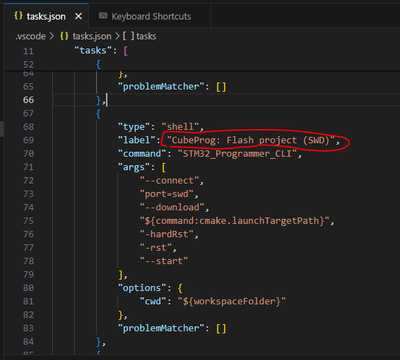

It is more of embracing a philosophical change. In VS Code you work more with keyboard shortcuts then with using your mouse to click on GUI buttons. Many developers would argue that this is more ergonomic / efficient. But the down-side is getting used to this and to learn the keyboard shortcuts... To make a complete answer on this topic for anyone reading this thread:
Today our VS Code extensions generates a tasks.json file (unless it already exist in your project, then we don't want to overwrite your stuff...) which provides a "task" labeled STM32: CubeProg: Flash project (SWD)
This is just a template we provide, feel free to modify to your needs!
To perform a "flash and reset" you can execute this task.
Executing this task can be done by "clicks" or by keyboard shortcuts.
If you choose the "click approach", then there will be several clicks since there is no dedicated button...
Also please notice that their are tasks named "Clean project" and "Build project". Option3 is the most efficient...
The other options require more than 1 user interactions.
