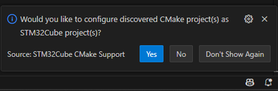

+ Already no need any more to import a project what is not so VSCode way of working. You just have now to add a project your VSCode workspace and like CMake tools extension is doing we are discovering live if added material may be a STM32Cube candidate. As end user you have to confirm it or not.
Part of new experience .. we are forcing nobody: end user has to get the control.

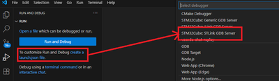

+ Once your project is a STM32Cube one, launch.json (and device flashing coming with) is generated either live under the hood pushing "Run & Debug" button
or if more control required, you can ask for "create a launch.json file" or add an extra configuration if exists already.
Based on launch.json we are fully supporting rich editor experience ... please rely on code completion to access the power of rich debug session we are supporting.
