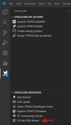

Currently, the same applies to Windows OS but with a different package: https://www.st.com/en/development-tools/stsw-link009.html. We are pointing these Thanks resources shortcut:
As part of our roadmap, we are working on smarter integration of all these features.
