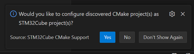

When opening a CubeMX-generated project in VS Code for the first time, a popup appears that—according to ST’s tutorial—you’re supposed to confirm by selecting “Yes”.
Unfortunately, the popup disappeared after a few seconds before I could click it. I’ve tried reopening both VS Code and the project, but it hasn’t appeared again.
How can I bring this popup back, or trigger the same setup manually?

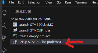

2026-02-10 3:23 AM
@Ricko
Please rely on following key action
2026-02-10 3:23 AM
@Ricko
2026-02-11 5:00 AM
Thank you @vincent_grenet
