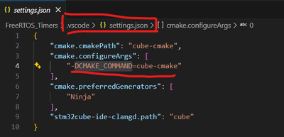

@Nicholas Parker
May it come from
Such said same as @vincent_grenet I'm unclear about your workflow.
.vscode/settings.json only operates if VS Code in use ... not impacting CLI execution out of VS Code for sure.
Re-created files may come from the fact you're engaging various version of cmake / ninja.
What about ?
cmake --version
cube cmake --version
ninja --version
cube ninja --versionWe’re moving the ST Community to a new platform to give you a better and more reliable community experience.
