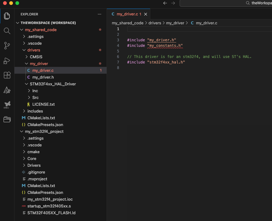

Hm, when I download this, and open the setup, and move the my_shared_code folder above the my_stm32f4_project, I still see errors in the my_driver.c file:

As for the error you're experiencing now, could you provide the error message that appears when you hover over the red squiggles? Also, did you run CMake's "configure" for both projects? I cannot see the "build" folders that are generated as part of this process in your screenshot.

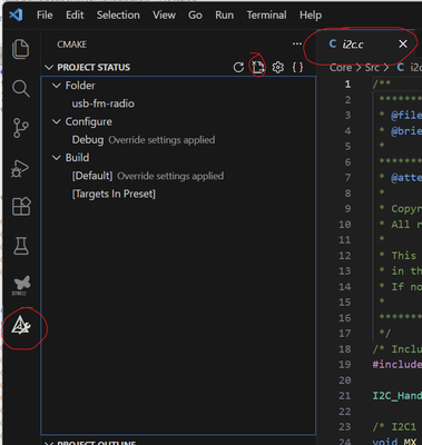

To run CMake's configure for both projects open "my_driver.c", the CMake's status window, and then re-configure the project. Refer to my screenshot for an example (although in here I have just opened a random file in my own project).
Do the same for "sysmem.c" in the other project. Note how the "folder" in the CMake status window should change as a result. If it does not change then a setting which allows this to happen is off somewhere in your user side preferences file. If so, just click the edit icon next to the first row under "Folder" (hover over to see it) and choose the other folder.
If you manage to configure both projects, do the red squiggles go away?

To your specific advice about this test setup we're working in, ah yes! I did not know I needed to "reconfigure" the cmake setup (and, indeed, hadn't noticed that little icon you pointed out, nor knew what it did). When I poke it, I indeed see the red squiggles (the error of which previously said "my_constants.h not found") went away and things behave as I'd expect. Thank you!
