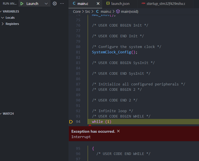

Anyway, it went through and the auto-breakpoint was set on the Reset_Handler: function in the startup file. When I ran it, it ran till the first line of the main function and there was no response.
When I paused it, it said Exception has occured and Interrupt.
1. What could be causing this issue? - I think pausing it has caused the error. I am not sure if that is how it reacts when the debugger is paused.
2. If the above issue is solved, does ST-Link GDB server trace the printf statements or should it be configured as well somehow?
Thank you once again.
