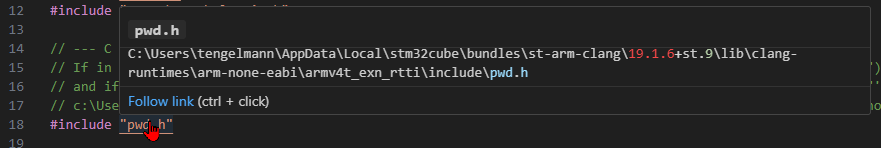

But if I hover the mouse over the plain C #include “pwd.h”, I see this path:
C:\Users\[user]\AppData\Local\stm32cube\bundles\st-arm-clang\19.1.6+st.9\lib\clang-runtimes\arm-none-eabi\armv4t_exn_rtti\include\pwd.h

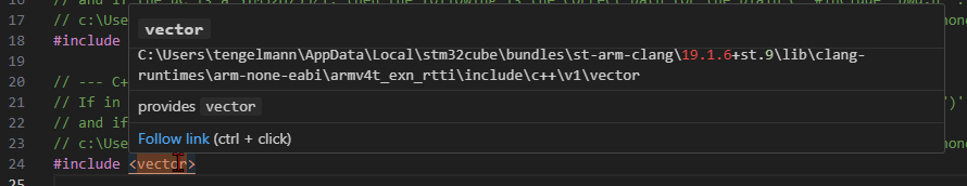

Similarly, the path is incorrect when I hovering over the C++ #include <vector>:
C:\Users\[user]\AppData\Local\stm32cube\bundles\st-arm-clang\19.1.6+st.9\lib\clang-runtimes\arm-none-eabi\armv4t_exn_rtti\include\c++\v1\vector

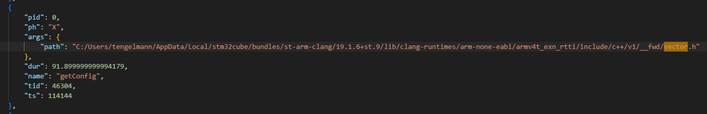

If I add --log=verbose and "stm32cube-ide-clangd.trace”: “clangd_trace.json” to settings.json,  it is possible to check what information clangd gets.
If I search for "vector" string I get lines with the correct path (in a "message" node):
but also with the wrong path:

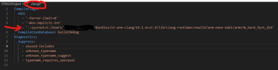

For now, I’m able to solve the issue by hacking the .clangd file.
This may help in the short term while we work on a more solid fix. Please confirm.
