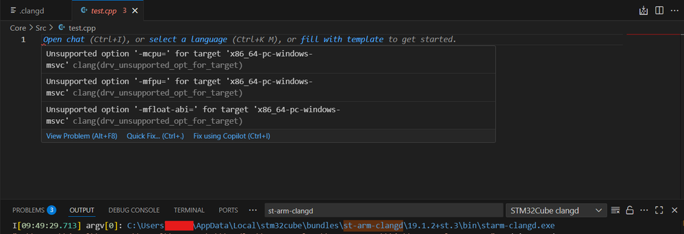

When building the project, it compiles fine, but clangd reports the following problem:
nsupported option '-mcpu=' for target 'x86_64-pc-windows-msvc'clang(drv_unsupported_opt_for_target)
Unsupported option '-mfpu=' for target 'x86_64-pc-windows-msvc'clang(drv_unsupported_opt_for_target)
Unsupported option '-mfloat-abi=' for target 'x86_64-pc-windows-msvc'clang(drv_unsupported_opt_for_target)
Is this a known issue?

Checking that it point to the correct compilation database in the way you suggest i get the following:
I[14:07:40.019] Loaded compilation database from c:\my\path\project_folder\build\Debug\compile_commands.json
Ok ... and what if looking for 'clangd.exe' as part of filter of the very same output channel ?
Are you getting in real something like '<local path>\st-arm-clangd\19.1.2+st.3\bin\st-arm-clangd.exe' ?
Asking because you have to rely on ARM embedded LLVM utilities not PC ones.
jostlowe
Associate III
 C:\Users\<username>\AppData\Local\stm32cube\bundles\st-arm-clangd\19.1.2+st.3\bin\starm-clangd.exe
Did what you suggested: Seems to be using the right utilities?
Yes it is. So ?
jostlowe
Associate III
Still seeing the same errors.
Its no biggie, as i got it to work with the fix in the .clangd file, but I thought it might be interesting for the devs of the STM32 VScode extension to have a look at
