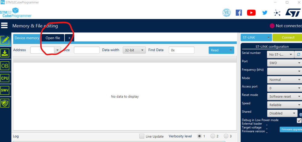

I was using STM32Cubeprogrammer for long time but suddenly Its main function of browsing and selection file option (OpenFile) stopped working. After multiple time install and uninstall it has the same behavior in a particular PC. I tried older versions & both 32bit-64bit variants but no luck. 0693W00000Un8uPQAR.png

Maybe because you have last open folder pointing to a resource not mapped anymore (e.g. network drive) ? Did you wait enought time (sometimes windows timeout is very very long)
If this is the root cause, don't know where this 'most recent path' could be reset.

@Imen DAHMEN​ I'm using latest version which is 2.11.0. No issues with antivirus it worked for sometime & yes I tried restart and reinstalling several time after clearing disk.
@PatrickF​, Yeah I've deleted the earlier folder being used as it was no longer required. I waited for long to be responded but no luck.

This bug occurs because STM32CubeProgrammer remembers the last file path it attempted to access and in the event of an error gets locked up and can no longer access files. This can happen either because there was an error with the file you attempted to open, or simply that the path you last accessed with the program no longer exists, like a network drive.
There is a file called config.properties which by default is located in:
<Your User Path>\STMicroelectronics\STM32CubeProgrammer
By deleting the saved values for readFileLastPathWB, readLastOpenFile, and readFileLastPath I was able to restart STM32CubeProgrammer and open files again.
