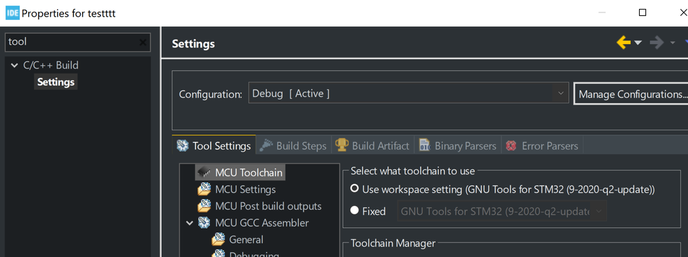

Not real sure. It works for me on STM32CubeIDE projects.
See if changing the toolchain in "MCU Toolchain" does anything.
