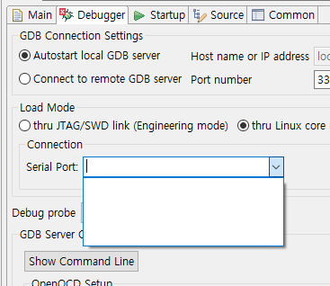

Now I am using stm32mp157a-ev1 board and coding M4 program on stm32cubeide.
However, there is a problem that the stm32cubeide stops at 70% after starting to run or debug.
And can check the log for errors in metadata.

I solved the problem. The serial port was resolved by setting it in Preferences.
[Window] -> [Preferences] -> [STM32Cube] -> [MPU Serial] / Check Remove filter
And in the new workspace there were no problems. However, the problem occurs only in the problematic workspace.
[workspace in problem] D:\project\Source\STM32Cube
[New workspace] D:\proejct\Source\STM32Cube\workspace1.12.0
It is presumed that the cause of the problem is, firstly, that the Remove filter was not set, and secondly, there was a problem with the workspace.

1.It worked before, but now it doesn't. I uninstalled and reinstalled, but it doesn't work.
2.A new project was created in a new workspace, but there was a problem that ST-Link Serial Port could not be found.
3.I tried rebuilding after "Clean project", but it doesn't work.
