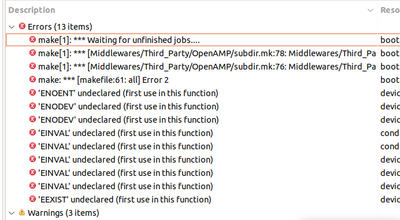

2025-04-10 4:43 AM - edited 2025-04-10 4:47 AM
Hi @Olivier GALLIEN ,
Thanks for your suggestion, I tried and fixed the same errors with STM32MP257F-DK, but a new problem appeared, the compiler did not find some macro as shown above.
Can you give me some ideas to fix them. Thank you very much.
