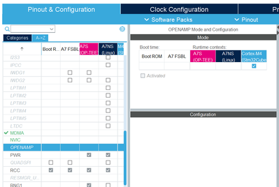

When I add OpenAMP to Pinout & Configration of .ioc and build it, the build fails
The steps are as follows:
- Select OPENAMP in Pinout & Configration -> middle ware & Software Packs
- Check M33NS(Cube)
- Also check Activated
- Save fuga_oka.ioc
Build the project. Some errors will be reported and the build will fail
