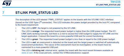

Hi PatrickF,
   So could I connect  5V adapter to CN21? Do I need to remove step6( Connect the USB type-C (power supply) port (1) to the power connector or a host PC, and check the power jumper position.)?
What document is it of this picture, could you share with me?Thank you
Yes, a 5V-12V 15W adapter is accepted on CN20, need JP4 to be moved to the other position.
