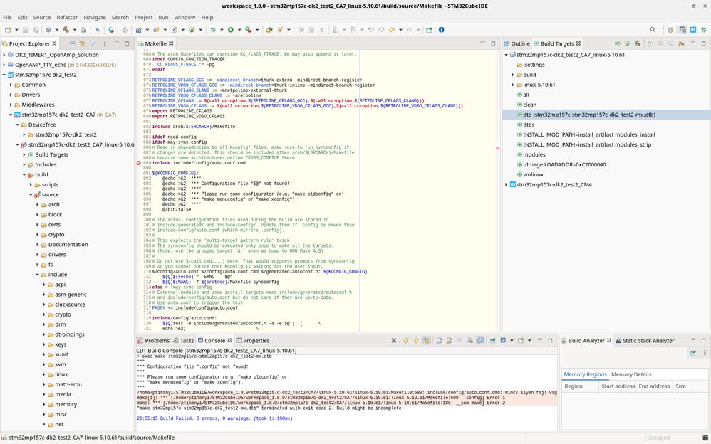

In CubeMX I select which IP belongs to which context. CubeMX generates the new device trees. How can I build .dtb's from these in CubeIDE?
The wiki page is not completely clear to me :
https://wiki.st.com/stm32mpu/wiki/How_to_manage_OpenSTLinux_projects_in_STM32CubeIDE
I cannot follow the steps described here because the compilation stops with the following error:
*** Configuration file ".config" not found!
*** Please run some configurator (e.g. "make oldconfig" or
*** "make menuconfig" or "make xconfig").
/home/ptihanyi/STM32CubeIDE/workspace_1.8.0/stm32mp157c-dk2_test2/CA7/linux-5.10.61/linux-5.10.61/Makefile:689: include/config/auto.conf.cmd: No such file or directory
make[1]: *** [/home/ptihanyi/STM32CubeIDE/workspace_1.8.0/stm32mp157c-dk2_test2/CA7/linux-5.10.61/linux-5.10.61/Makefile:698: .config] Error 1
make: *** [/home/ptihanyi/STM32CubeIDE/workspace_1.8.0/stm32mp157c-dk2_test2/CA7/linux-5.10.61/linux-5.10.61/Makefile:185: __sub-make] Error 2
"make stm32mp157c-stm32mp157c-dk2_test2-mx.dtb" terminated with exit code 2. Build might be incomplete.So many things work, but I think a simple "Hello World"-like "walkthrough" with a complex project involving Cortex-M4 and Cortex-A7 and device tree would be a great help for everyone.
