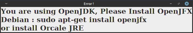

cube programmer doesn't work on linux
It gives error JavaFX NOT installed => warn user
but javafx is installed (sudo apt-get install openjfx)
Linux Mint 19.2 Tina
4.15.0-60-generic #67-Ubuntu SMP

I have java and all the extra packages installed, other java based programs are working fine.
I get this dialog, i have openjdk 11.0.4 and also installed openJFX as instructed in the dialog, still doesn't work.
Also tried with oracle jre, the same dialog is shown.

I read from another forum that the newest JREs/JDKs don't ship with a folder called 'jre' anymore, and CubeProgrammer is set to only check if the folder exists during startup.
Apparently there is no way around it. I ran into the same issue with this one, and can't get the tool to work.

Hi @TOlli
We confirm this issue with recent version of OpenJDK and we are sorry for inconvenience.
Workaround is to install OpenJDK 8 or Oracle JRE 8.
ST is working to be independent from this Java version in future release of its tool for beg year 2020.
