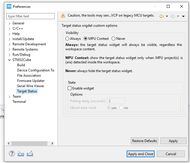

I did the exact same test with STM32CubeIDE 1.3.1 and I got the button visible in the toolbar:
You might have changed the MPU Ui elements visibility to 'never' from the preferences:
HTH
