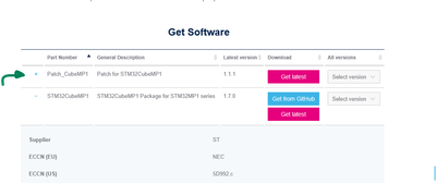

Hi @shivam203
It wasn't fixed in 1.7.0 so maybe in next release.
Also while here perhaps we should ask if Patch_CubeMP1 is still required ?
This patch was released back in 2019.
Do we still need it in 2025 ?
Regards
Dub
