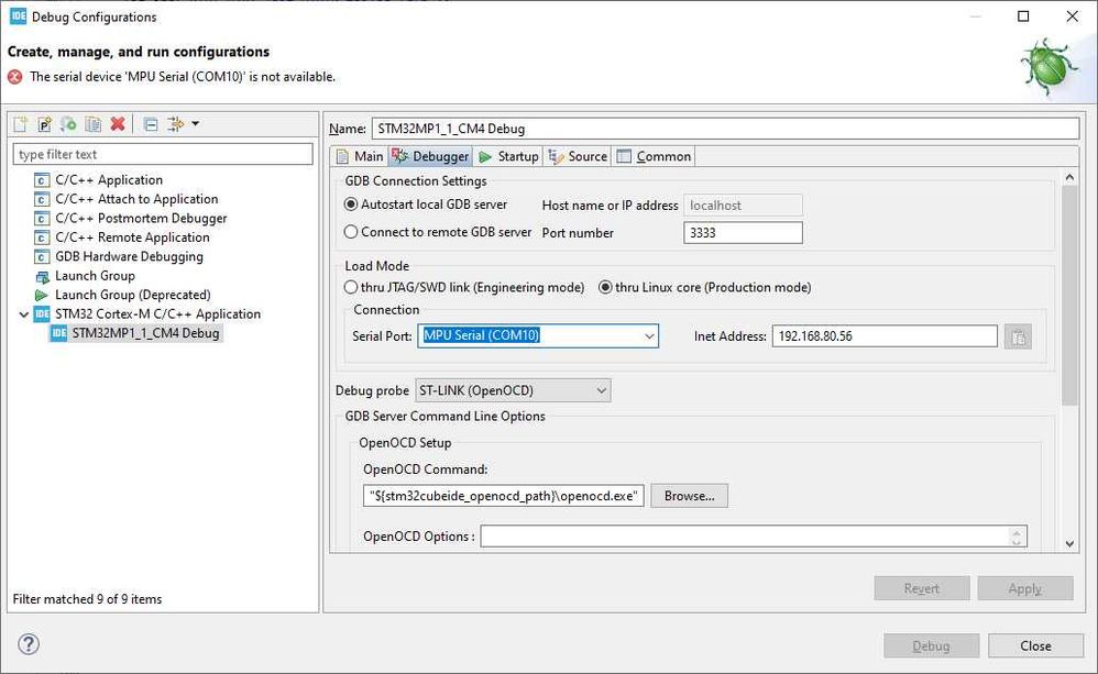

There is an error message blocking me from debug. The label "Connection" in frame header is blinking...
/Peter

When there is both an STLink connection and FTDI connection, then FTDI is chosen by CubeIDE. My problem is that FTDI port is not a linux console, but an application proprietary port.
At Window | preferences | STM32Cube | MPU Serial there seem to be a feature to choose a preferred com-port, but that is without effect for me.
I can see that wrong port is selected and fails to open since I have putty already opened the FTDI com port.
