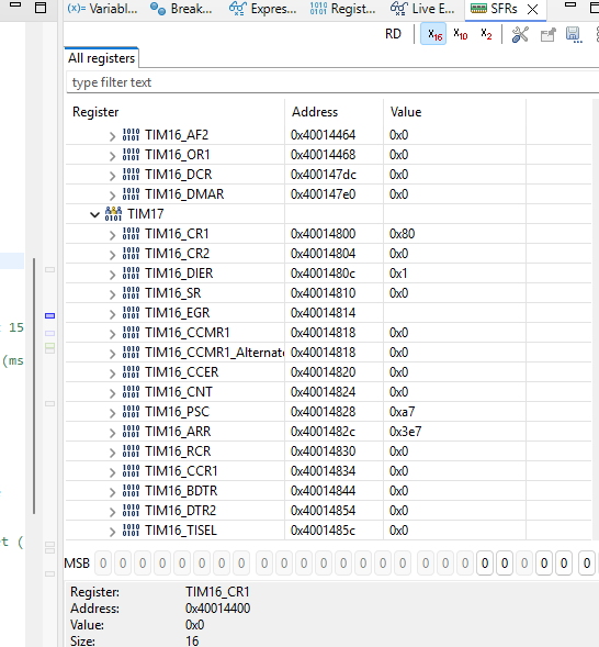

I am currently using this version of CubeIDE. [Version: 1.18.0 Build: 24413_20250227_1633 (UTC)] with a STM32G473QET6 CPU
I noticed that in the debugger SFRs window there is an error in the name of the TIM17 registers (they were called TIM16_xxx)
