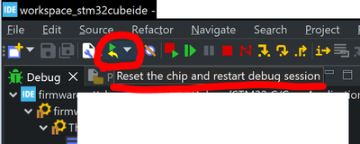

I don't know about MPUs but with MCUs you can press the following icon when in debug mode. It's probably the same for you:
2023-10-29 11:31 PM
That would be too easy, :grinning_face: unfortunately exactly this button is greyed out at the MPU'S

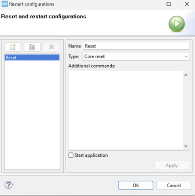

I have to share a new insight,
when i change Debug probe connection from OpenOCD to GDB Server the Button is still greyed out.
But wit a core reset i was able to hit an early breakpoint at the beginning of main.
As ugly workaround for the missing Reset Button it is possible to reset M4 by
Run->Restart Configurations --> Core Reset --> OK
2025-03-07 2:03 AM
Golden info, thank you so much!!! Why is this not written in any document or wiki... ?
If it's possible to do the Core reset from the menu, why is this not linked to the button... Mystery :\
