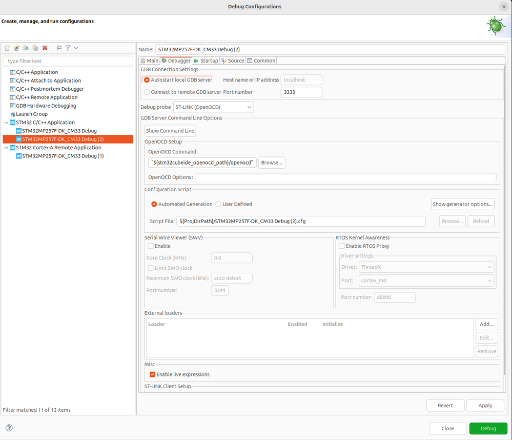

Could you please check the GDB debugger on the debug Configurations

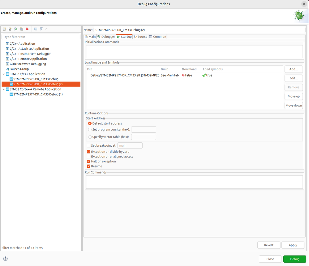

Here are my debug settings:

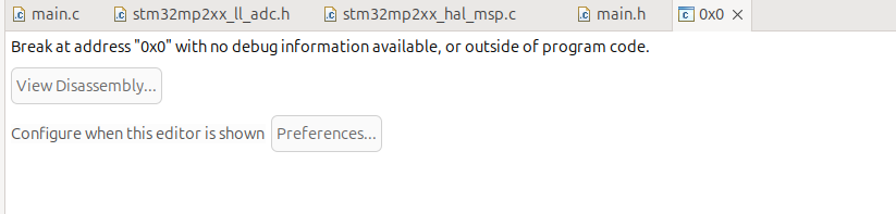

Then clicking on the "Debug" button gives the following response:
And the following output log is printed to the console:
