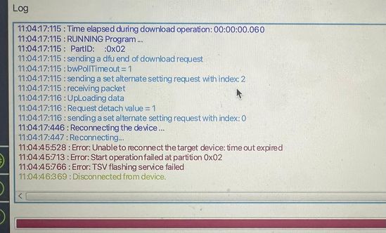

The second prototype stops after having downloaded the partition 0x02:
On the USB debug I have:

Any idea what could cause this "Unable to reconnect the target device" ?
