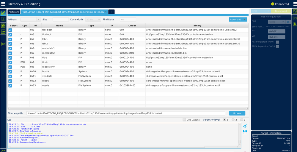

Problem:
When I try to flash using the STM32 flashing tool Using Usb, it gets stuck after the 0x03 partition.
I suspect this is due to version mismatch between CubeMX-generated files and my Yocto version.

Cube Programmer

├── st-image-vendorfs-openstlinux-weston-stm32mp135df-comtrol-20251023130245.vendorfs.manifest
├── st-image-vendorfs-openstlinux-weston-stm32mp135df-comtrol-20251023130245.vendorfs.tar.xz
├── st-image-vendorfs-openstlinux-weston-stm32mp135df-comtrol.ext4 -> st-image-vendorfs-openstlinux-weston-stm32mp135df-comtrol-20251023130245.vendorfs.ext4
├── st-image-vendorfs-openstlinux-weston-stm32mp135df-comtrol.manifest -> st-image-vendorfs-openstlinux-weston-stm32mp135df-comtrol-20251023130245.vendorfs.manifest
├── st-image-vendorfs-openstlinux-weston-stm32mp135df-comtrol.tar.xz -> st-image-vendorfs-openstlinux-weston-stm32mp135df-comtrol-20251023130245.vendorfs.tar.xz
├── st-image-vendorfs-openstlinux-weston-stm32mp135df-comtrol.testdata.json -> st-image-vendorfs-openstlinux-weston-stm32mp135df-comtrol-20251023130245.testdata.json
├── st-initrd-openstlinux-weston-stm32mp135df-comtrol
└── u-boot
├── debug
│ └── u-boot-stm32mp13.elf
├── u-boot-nodtb-stm32mp13.bin
└── u-boot-stm32mp135f-stm32mp135df-comtrol-mx.dtb
14 directories, 82 files
Machine.conf
#@TYPE: Machine
#@NAME: stm32mp13-disco-mx
#@DESCRIPTION: [STM32CubeMX-EXAMPLE] STM32MP135F-DK board ONLY with Optee boot and SDcard support
#@NEEDED_BSPLAYERS: layers/meta-openembedded/meta-oe layers/meta-openembedded/meta-python
# Default machine configuration sections
include conf/machine/include/st-machine-common-stm32mp.inc
include conf/machine/include/st-machine-providers-stm32mp.inc
# Define specific common machine name
MACHINEOVERRIDES .= ":stm32mpcommonmx:stm32mp13commonmx"
MACHINEOVERRIDES .= ":stm32mp1common:stm32mp13common"
# Chip architecture
DEFAULTTUNE = "cortexa7thf-neon-vfpv4"
include conf/machine/include/arm/armv7a/tune-cortexa7.inc
# boot scheme
BOOTSCHEME_LABELS ?= ""
# boot device
BOOTDEVICE_LABELS ?= ""
# Machine settings
STM32MP_DEVICETREE = "${CUBEMX_DTB}"
# Machine features (default for stm32mp1 like)
MACHINE_FEATURES += "splashscreen"
MACHINE_FEATURES += "watchdog"
MACHINE_FEATURES += "nosmp"
# Device Storage
# Enable the board device storage support with CUBEMX_DTB according to BOOTDEVICE_LABELS
DEVICE_BOARD_ENABLE:SDCARD += "${@bb.utils.contains('BOOTDEVICE_LABELS', 'sdcard', '${CUBEMX_DTB}', '', d)}"
# Flashlayout
# Set the FLASHLAYOUT_TYPE_LABELS to CUBEMX_DTB according to BOOTDEVICE_LABELS
FLASHLAYOUT_TYPE_LABELS:sdcard = "${@bb.utils.contains('BOOTDEVICE_LABELS', 'sdcard', '${CUBEMX_DTB}', '', d)}"
# Specific settings for 'extensible' and 'deleteall' configurations
FLASHLAYOUT_CONFIG_LABELS:deleteall = "cubemx"
FLASHLAYOUT_TYPE_LABELS:deleteall:cubemx = "${CUBEMX_DTB}"
FLASHLAYOUT_TYPE_LABELS:extensible = "${CUBEMX_DTB}"
# CubeMX extra config
ENABLE_CUBEMX_DTB ?= "1"
# User machine customization sections
# Boot Scheme
BOOTSCHEME_LABELS += "optee"
# Boot Device Choice
# Define the boot device supported
BOOTDEVICE_LABELS += "sdcard"
# Support Feature Choice
# Define the features to enable on board
MACHINE_FEATURES += "bluetooth"
MACHINE_FEATURES += "wifi"
MACHINE_FEATURES += "usbg0"
# Specific firmwares and kernel modules configuration
# Set the list of kernel module to be auto-loaded during boot
KERNEL_MODULE_AUTOLOAD += ""
# Set Bluetooth related package list needed when 'bluetooth' feature is enabled
# NOTE 'linux-firmware-bluetooth-bcm4343' firmware is specific to BT/WIFI
# combo used on DISCO boards"
BLUETOOTH_LIST += "linux-firmware-bluetooth-bcm4343"
# Set Wifi related package list needed when 'wifi' feature is enabled
# NOTE 'linux-firmware-bcm43430' firmware is specific to BT/WIFI combo used
# on DISCO boards
WIFI_LIST += "linux-firmware-bcm43430"
# CubeMX Project Config
# Assign CubeMX Board devicetree and project path name
CUBEMX_DTB = "stm32mp135f-stm32mp135df-comtrol-mx"
CUBEMX_PROJECT = "mx/stm32mp135df-comtrol"
# Indicate which STM32MP package are used: 'A', 'C', 'D' or 'F'
CUBEMX_SOC_PACKAGE = "F"
# Indicate the size of DDR available on BOARD: 512 or 1024 (size in MB unit)
CUBEMX_BOARD_DDR_SIZE = "512"
# Indicate if you like to disable the DVFS which are activated by default
CUBEMX_SOC_DVFS_OFF = "0"
2025-11-06 2:25 AM
Hi @Midhul_Pk
At first sight your CubeMX version seems not align with OSTL one.
Please clarify the whole ecosystem. Kirkstone is no more maintained.
Olivier
