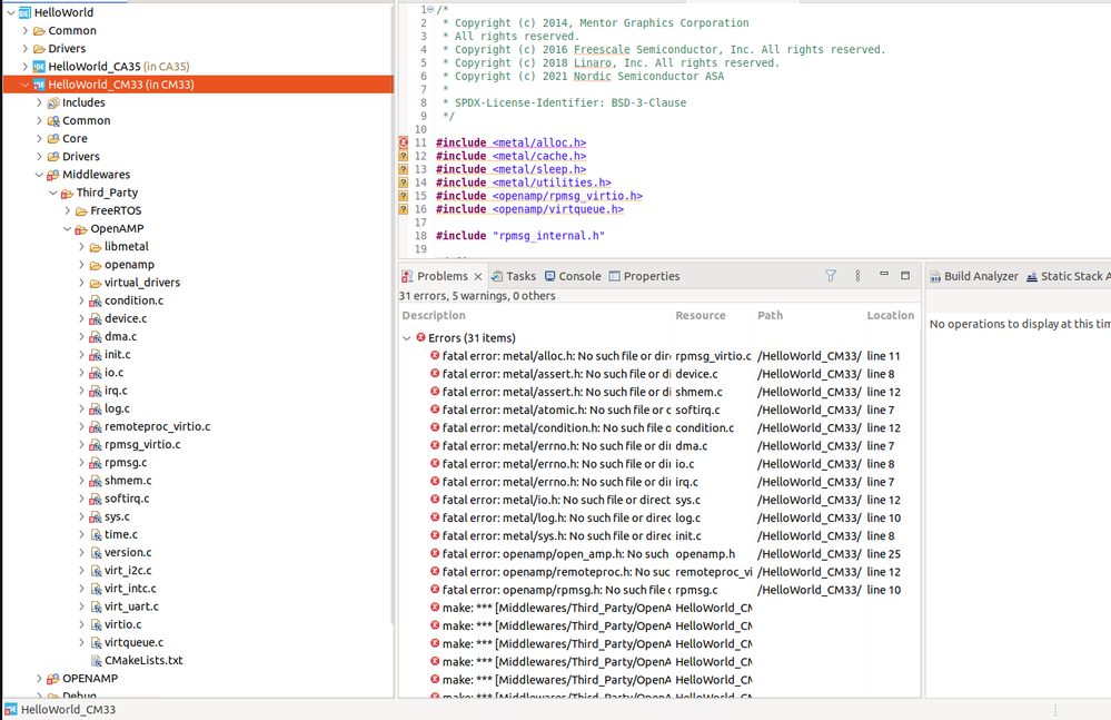

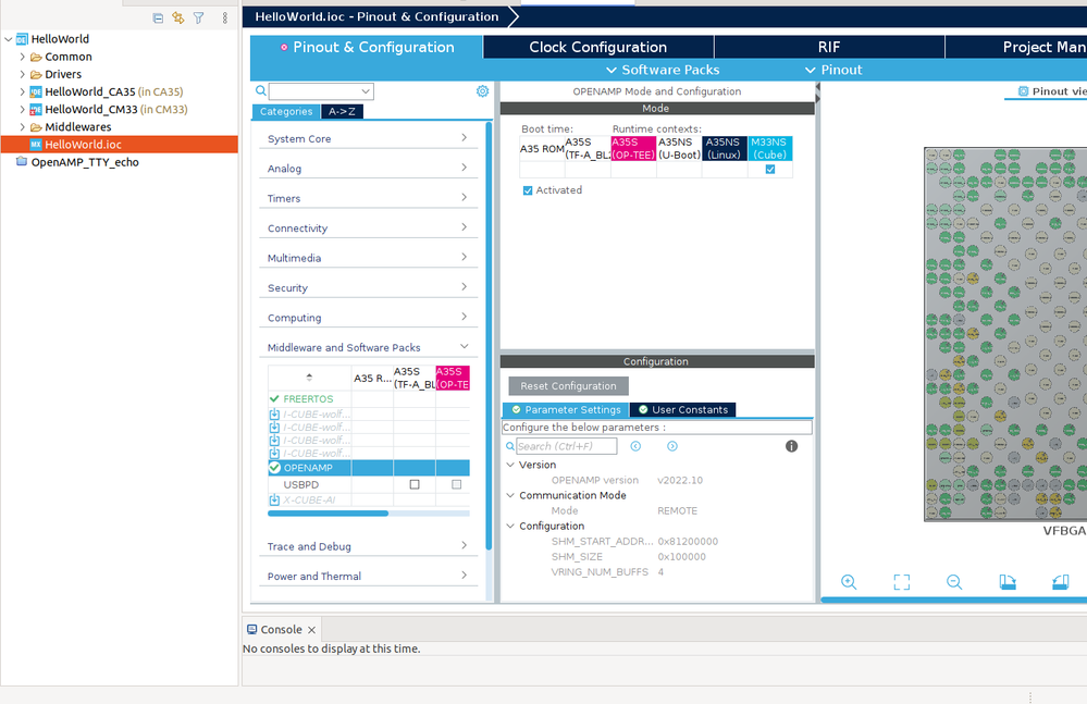

I have a project in STM32CubeIDE that uses the STm32MP257. I want to create my own distro and application for both the A35 and M33 processors.
I have no issues with the Linux side of things, I can build the distro and user application, i am having issues with the Cortex M33 processor. if i generate a project that doesn't use the OpenAMP middleware (using the .ioc file) the M33 project will compile perfectly. If i then include the OpenAMP middleware and generate the code, I get lots of errors with missing files and its a bit of a mess!
Please could you offer some help here, the documentation all points towards developing apps for just the dev kits, this isnt good for me, i want to develop a completely custom application with different pinouts etc. I have got all the correct Firmware packages and patches applied in the Repo folder of STMCubeIDE.
2025-09-05 2:24 AM
Its a bug, you can find similar issue in other posts.
My finding: OpenAMP's dependency library libmetal is cmake project. which CubeMX/CubeIDE doesn't setup properly. it generates only makefile, which is not enough. So headers doesn't get produced in tree and out build fails.
