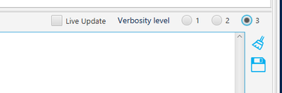

4. Change the verbosity level of the Cube Programmer to 3 and share the logs.
