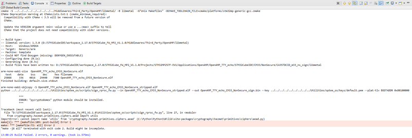

the project : OpenAMP_TTY_echo is loaded correctly, and the build of _ns is completed OK
When I choose (with the hammer) the _ns_sign
I get this error :
Th trackback shows: ImportError: cannot import name 'utils' from 'cryptography.hazmat.primitives.ciphers.aead' (C:\Python\Python310\lib\site-packages\cryptography\hazmat\primitives\ciphers\aead.py)
It looks like a python path issues of the STM32CubeIDE,
How should I sol

Updating that the issue was solved by
uninstalling Cryptography => pip uninstall Cryptography
re installing Cryptography version 3.1.1 => pip install Cryptography==3.1.1
checked this externally in command prompt running: python sign_rproc_fw.py from the directory of installation (
