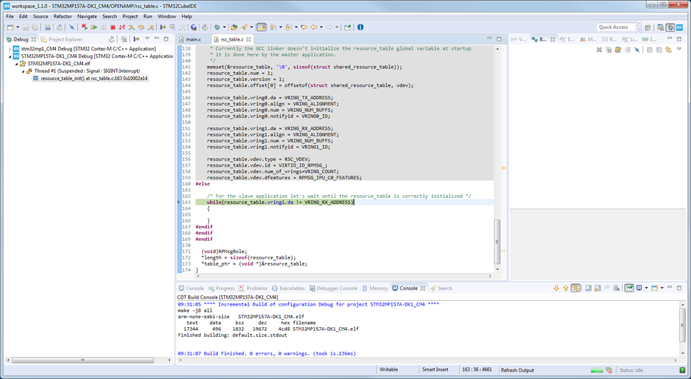

I have the same problem with STM32CubeIDE 1.1.0. I created a project for the STM32MP157A-DK1 board with default settings. The M4 stucks while OPENAMP init in the function resource_table_init. I have 2.6-openstlinux-4.19-thud-mp1-19-10-09 running on the A7.

I have some problem.
Infinit loop:
while(resource_table.vring1.da != VRING_RX_ADDRESS)
