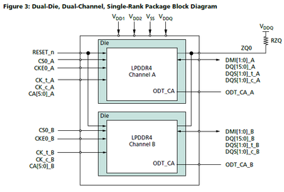

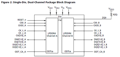

MT53E512M32D1ZW-046 WT:B is a 16Gbit single-die dual-channel Z42M (older).
the MT53E1G32D2FW-046 WT:C is a 32Gbit dual-die dual-channel Z42N (more recent).
There is certainly some difference in the settings, please check respective datasheet and AN5723
Regards.
