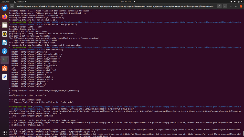

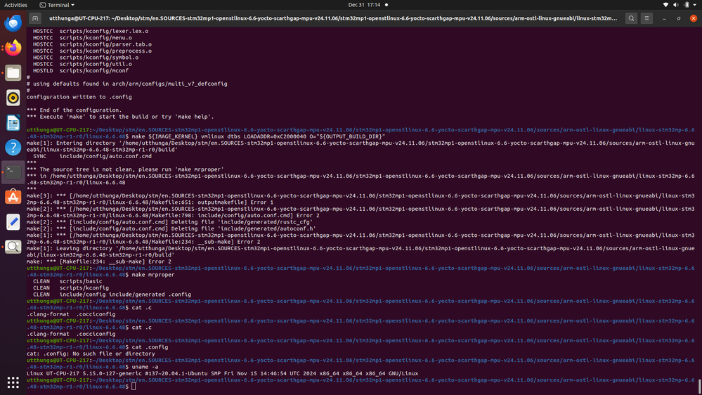

Currently we are facing issue in loading a custom kernel on STM32MP157A).
