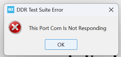

I am trying to use the DDR test suite from Cube IDE with a custom board based on the STM32MP257FAI3 with 32Gb of LPDDR4 (MT53E1G32D2FW-046 WT:B). The board doesn't have engineering boot available, but it does have USB/UART boot, so I have been attempting to use SYSRAM Loading in the DDR Test Suite. However I have been getting "This Port Com Is Not Responding" errors when trying to connect.

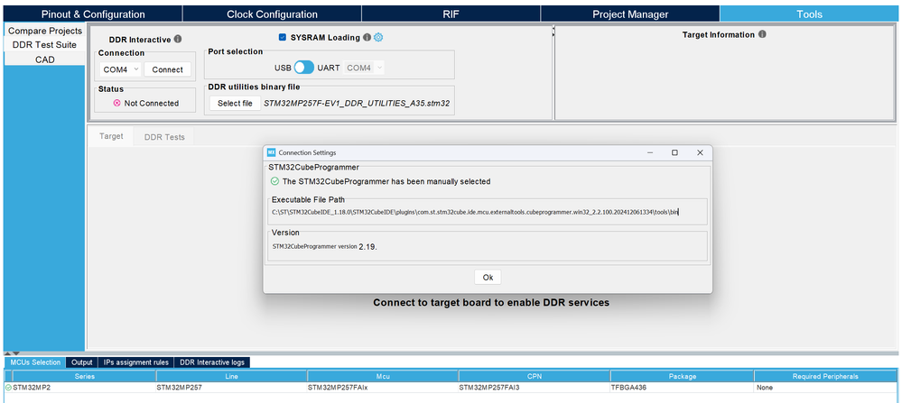

  3. Create a Cube IDE project for the board with all the correct options set for peripherals and clocks.
  4. Go to Tools > DDR Test Suite and configure the options for USB upload, and with one of the .stm32 files generated in step 2.
  5. At this point I set the board so all the boot pins are low and reset it. Device manager shows both the STLINK V3MINIE's UART connection (COM4) and the USB connection to the STM32MP2:
  6. I then press connect and a progress bar appears. Once the progress bar gets to 100% it disapears and an error message pops up:
Any idea how to fix this? It seems similar to this other post about SYSRAM loading on an STM32MP157F-DK2.
I have also tried using UART rather than USB and that has exactly the same error.

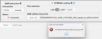

ben5049
Associate
I just tried the "STM32MP257F-EV1_DDR_UTILITIES_A35_nopad_no_el3lnch.stm32" file and this time it finished uploading, then briefly flashed something in the Target Information window, then gave a new error message:
Same results with USB and UART...
