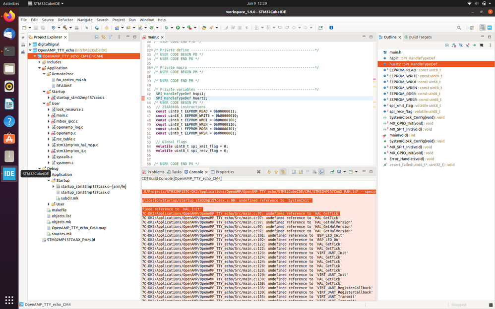

2022-06-09 9:30 AM
Here's the screenshot. I'm using Linux Debian 5.13.0-44-generic
2022-06-09 10:12 AM
Here's the screenshot. I'm using Linux Debian 5.13.0-44-generic. I'm pretty sure the -j8 and -j3 distinction are references to the number of computing cores used in the make process.
2022-06-28 6:40 AM
Hello @FHyat.1 ,
Yes the -j8 is related to the number of cores used, you are right.
For information the ST solution is tested on Ubuntu 20.04 and 18.04, not on the other distribution.
The recommended setup is Ubuntu 20.04 LTS:
https://wiki.st.com/stm32mpu-ecosystem-v3/wiki/PC_prerequisites#Linux-C2-AE_PC
So this is maybe a problem due to Debian, but I do not think this is the case.
Your problem looks like the project is not able to find the drivers code of your STM32Cube_FW_MP1_V1.5.0.
For example in your traces:
undefined reference to `HAL_GetTick'This function is normally defined in STM32Cube_FW_MP1_V1.5.0/Drivers/STM32MP1xx_HAL_Driver/Src/stm32mp1xx_hal.c at line 359.
So if your linker is not able to find it, this is because the file was not built during the build.

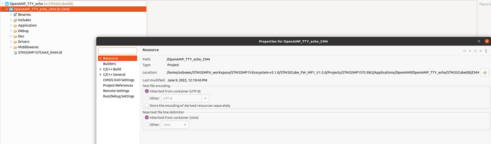

Please can you make a right click then properties on your project "OpenAMP_TTY_echo_CM4", like this:
I would like to see the location of the tty_echo project that you included into cubeIde.
