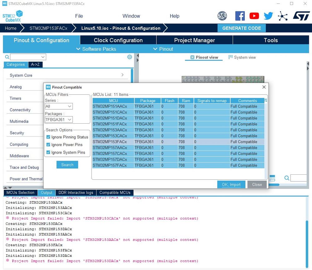

I attempted to migrate from STM32MP157F to STM32MP153C using the standalone CubeMX tool, but failed because "multiple context"
Output says "Project Import failed: Import 'STM32MP153AACx' not supported (multiple context)

Any updates on this? I received the same "multiple context" error when I try to import a project, even when importing a project into the exact same MCU.
2024-02-06 10:38 AM - last edited on 2024-02-06 11:48 PM by Peter BENSCH
Sounds like the import functionality is not supported when selecting a dual-core microcontroller in the STM32H7 series (and this might apply to other dual-core systems, too). This info is mentioned on page 16 here, "Import from and to dual-core STM32H7 is not supported."
