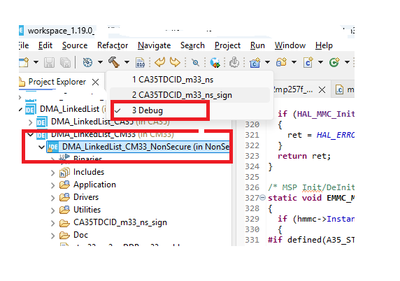

Yes, you can debug the M33 through a hot attach. First, you need to import the project from STM32CubeIDE, then build the code using the 'Debug' option (see the screenshot below). I am I am using the example of DMA_LinkedList_CM33_NonSecure.

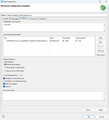

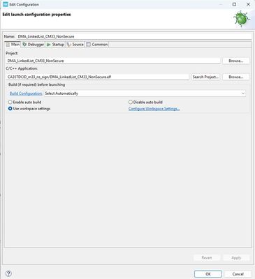

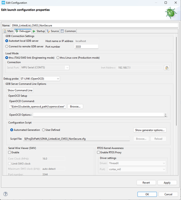

After that, open the debug configuration, and you will be able to debug (see the screenshot below).
