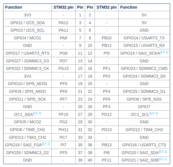

The GPIO pins for the MISO,MOSI and NSS how do i select them for SPI5 ?

};my question is the gpios. this line "cs-gpios = <&gpioz 3 0>;" appears wrong to me because in the example these are for spi4 i guess but i need to use spi5 in wiki i found this:
https://wiki.st.com/stm32mpu/wiki/STM32MP157x-DKx_-_hardware_description#GPIO_expansion_connector
which pins should write in to "cs-gpios = <&gpioz 3 0>;" this function can figure it out; my guess is "cs-gpios= <&gpiof 6 0>" but im not sure
