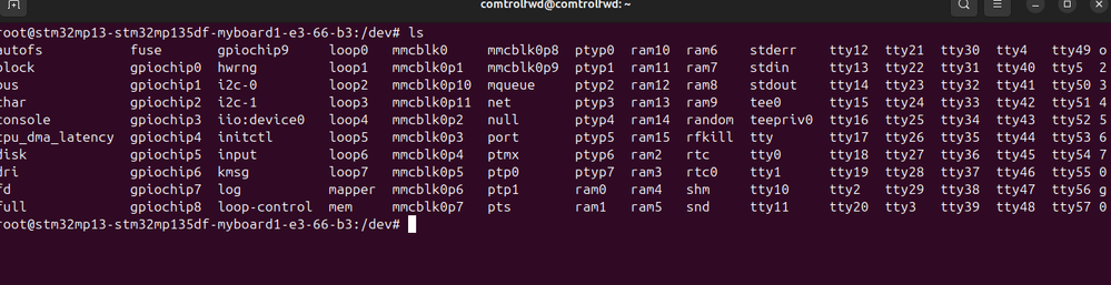

After building and flashing the st-image-weston, I don’t see any spidevX.Y device node in /dev.

2025-04-24 2:30 AM - edited 2025-04-25 1:16 AM
