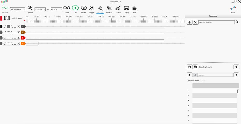

waveform
I observed four signals:SCLK/MOSI/DC/RESET.(the CS is by default connected to gnd.
but there is no action on SPI.
I suspect there is still something wrong with the configuration of the device tree, but I don't know how to configure it.

Associate III
The following is the wave, the channel 3 is the RESET signal:
