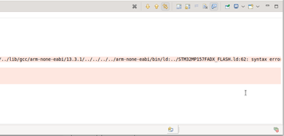

1. STM32 Cmake project
2. Select executable option.
3. Chose the MPU
4. Build
ERROR
2025-12-02 12:18 PM
it's default, so it should work.
2025-12-13 2:56 PM
This issue is still present on latest toolchain, please help.

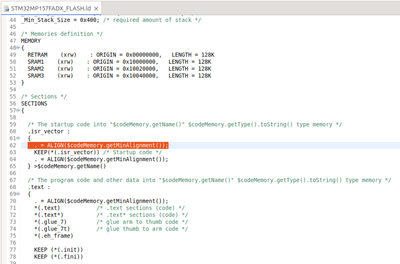

2025-12-18 2:31 AM
Hi @embeddedbro
Did you refer to wiki ?
At first sight "Core 0" seems not good as it's the A7 core not supported.
