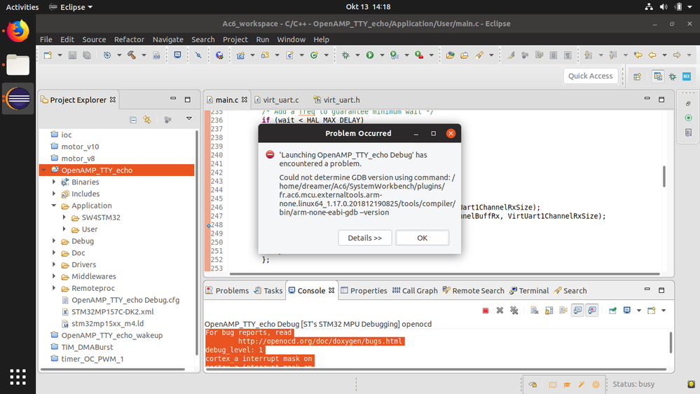

I am trying to debug my M4 program on systemworkbench (eclipse) for the board stm32mp157c-dk2 and the host computer is ubuntu. I have set breakpoints in normal flow and also in exceptional flows in the program. Program works very well in debug and I can see the outputs via my qt program on linux side on mini display. But the flow never stops by breakpoints. The breakpoints have no effect. I am doing the following steps correctly. Please tell me what is missing or what I am doing false...
And this is the log on console when the debug starts

ap 0 selected, csw 0x10006000And the pop up which is coming and that I dont think it is a serious problem (not sure) is here:

Hi @IYetk
Pop up error is a serious problem.
May I recommend to attempt a reinstallation of SW4STM32 ?
Else we are announcing STM32CubeIDE V1.1.0 which is now the new reference eclipse IDE for STM32MP1 and is about to be available on st.com
