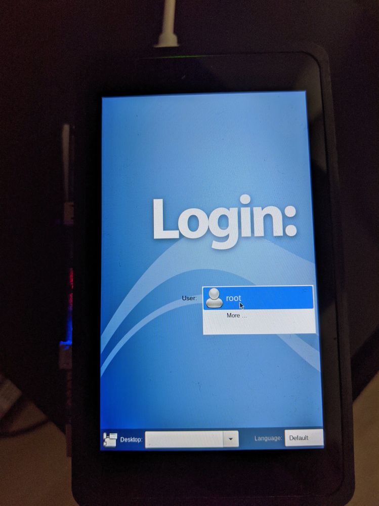

2020-03-21 3:59 AM
Hi, I also build st-example-image-x11 and flashed it on stm32mp157 DK2. But when device boots, it shows login screen with "root" user and i can't log in and move to desktop. Did you have same problem ? How you logged in ? Did you change something in local.conf file or bblayers.conf ?
Here is the screen:
2020-03-22 2:21 AM
Hi, You must configure start-up files in / etc / lxdm:
https://wiki.archlinux.org/index.php/LXDM
Regards,
Adrian

2020-03-23 3:36 AM
When you deploy your image on board, you was able to log in, or do something ?
Maybe i compiled it wrong. When i click on root user, black screen appear for few seconds and then system again return to login page.
2020-03-23 4:44 AM
Lxdm after click to root, runs PreLogin and PostLogin files, when it is empty it back to logging page. You moust to configure them like in instructions on:
Regards,
Adrian
